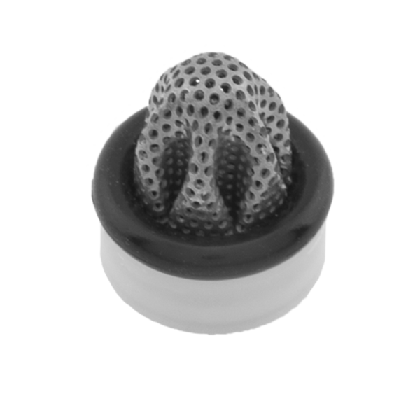

GlobalMAX Final Filter Assembly
317034
The final filter, also referred to as the last chance filter, sits in the nozzle body of the Cutting head to remove any impurities which could affect the flow of the jet stream as it exits the nozzle orifice. The filter should be checked and cleaned in an ultrasonic cleaner weekly and replaced as needed. This filter assembly is used on the GlobalMAX only and is the replacement for P/N 317037. The filter removal tool is P/N 319947.
