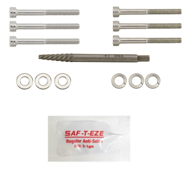

The shear screws on the A-Jet are designed to break away and reduce damage to other critical components inside the A-Jet assembly. These shear screws need to be replaced whenever damaged or once the machine faults due to a head crash. Replacing these bolts MAY NOT fix the damage to the A-Jet. All 3 shear screws must be replaced if any are damaged. The machine may experience an extreme run-out if a shear screw is damaged. This kit contains all the parts and instructions needed to complete the procedure.
